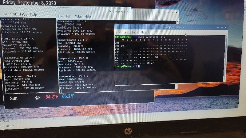

      For reference sake I focused on a couple of BME688’s to give you sort of a benchmark.
      First is screenshot showing both BME’s running. Had to do jumper on one to get a second address 0x76 and 0x77

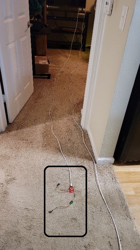

          @ankonaskiff17 50 ft ethernet
          And the money shot. 50 ft cable
