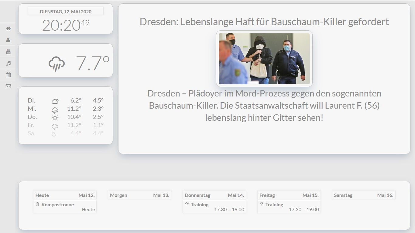

      Here is my bright ui for our kitchen monitor. The CSS is for the standard config of the MM.

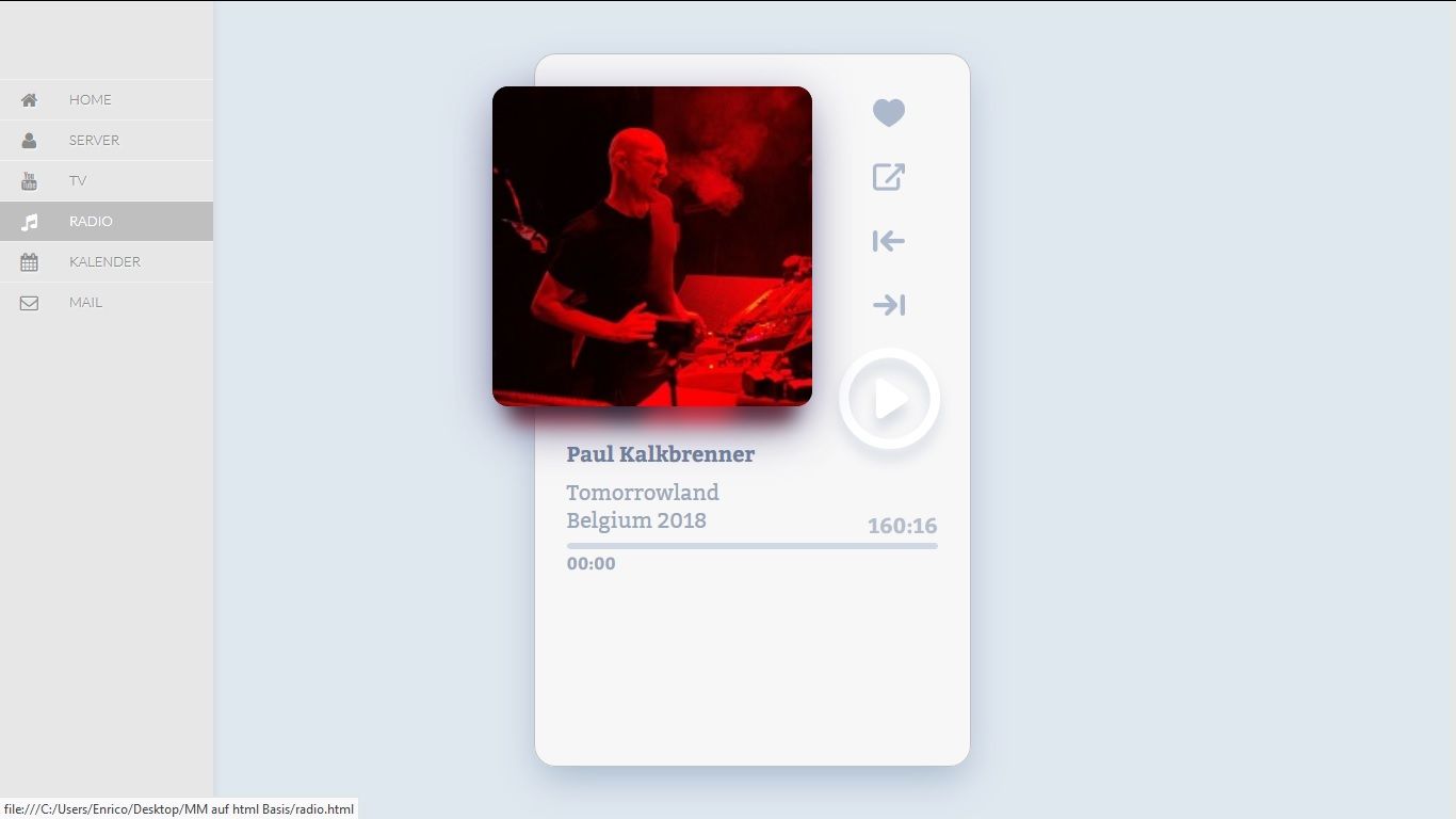

      The MagicMirror runs in an iFrame of an html page, the other pages are all written in html and css.
      Here is the result for the standard config.
      In the config, compliments must be set to center.
      			module: "compliments",
      			position: "center"

        wow…what is that newsfeed with pics module?

            Can you please post your “config.js” file (without personal information off course) and the name of module used ?

              @cyberphox it is MMM-News

                  @Piranha1605 OK, thanks but what is that module vertical from left side and where is the radio ?

                    As already described above, it is a website in which the MagicMirror only runs as an iFrame; the radio and the menu are not in the MagicMirror.

                        Is that Tileboard or something similar you are running for the menu on the left?
