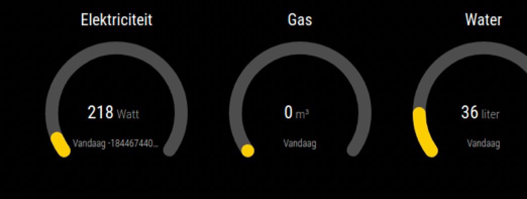

                  Hi tanks for great module. I have a small problem with the counter today from the power consumption. this doesn’t show me the amount of use of the day. Gas and water working fine. see screenshot. Do you have a solution, or where I have to search? !!Schermafbeelding 2021-07-24 om 20.59.12.jpg
                  G 1 Reply Last reply Reply Quote 0

                      Alle data is retrieved from the JSON response. Could you post it for the electricity counter?
                      M 1 Reply Last reply Reply Quote 0
