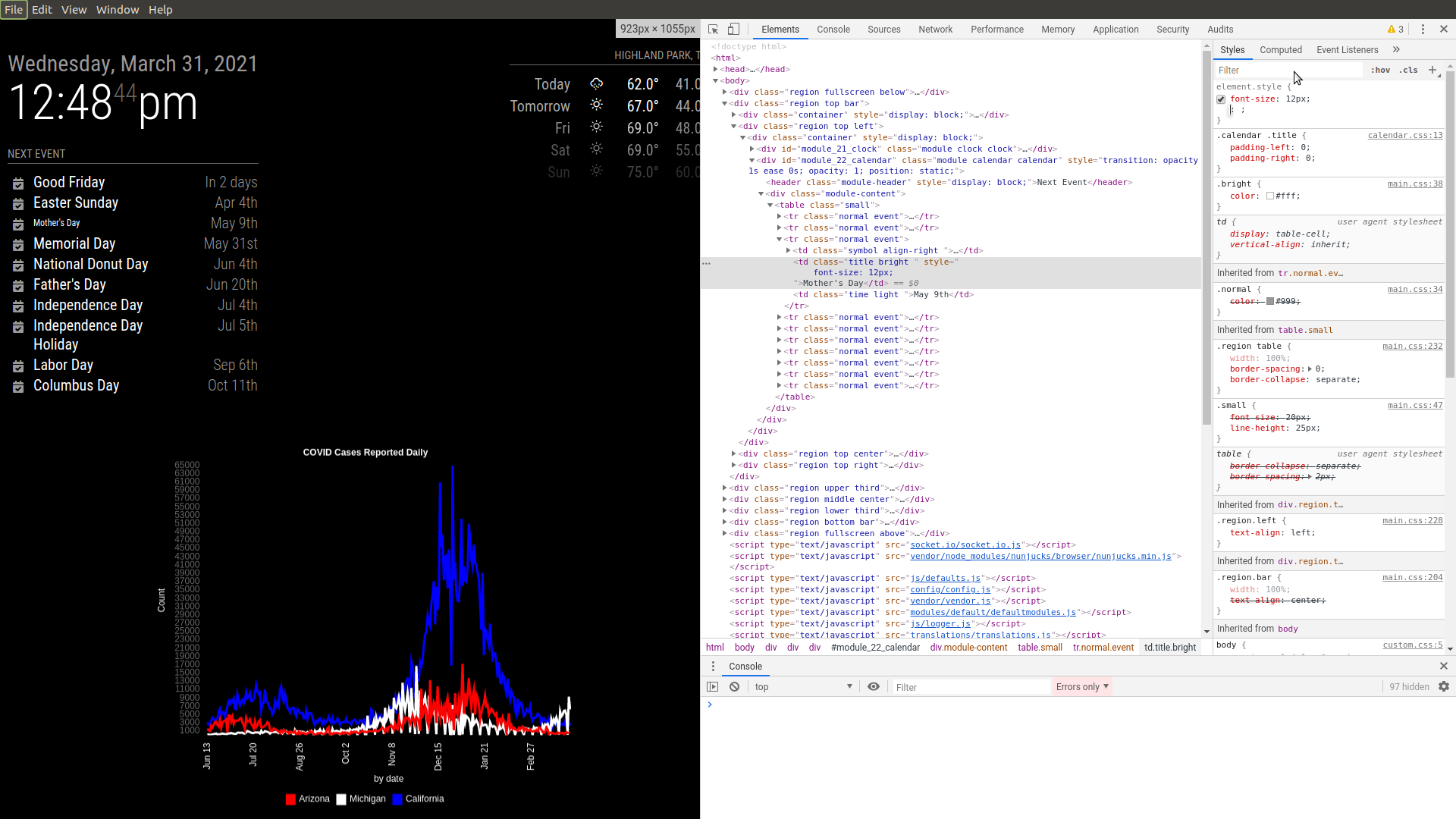

        @nneuland time to learn the developers window
        on the MM screen, press ctrl-shift-i, a new window will open beside your mm screen
        select the elements tab
        in the upper left corner of the elements page is a pointer symbol (box with mouse pointer in it) , click it with the mouse
        and then use your mouse to locate the content in the MM screen u want to analyze
        (as u navigate, different areas of content will be highlighted)
        click on the content u are interested in… and the web page tree will open to that content (pink). and the bottom of the page will show the class name list left to right(green), with rightmost the one set closest to the content, left most set by MM
        also on the right column is the class hierarchy, closest at the top, furthest MM further down…
        SO, you want to find the class that sets the fontsize, and edit the topmost right column entry (black) field to add a new fontsize and see it change (Mothers day entry in this example is a different font size now)
        so, now you know what and where

                sdetweil @Nneuland
                @nneuland so, in custom.css you need this pattern
                .modulename (space) .classname {
                    stylename: value;
                SO, in this case from the dev window
                go up to the module_11_MMM-nyc-transit
                remove the module_11_ prefix and add a dot
                .MMM-nyc-transit
                then we need the class name of the element u want to change
                mta__train–list (add a dot in front)
                now we have
                .MMM-nyc-transit   .mta__train--list {
                it IS font-size: medium;
                in main.css
                .medium {
                  font-size: 30px;
                  line-height: 35px;
                u want to change that, SO
                        font-size:   20px;
