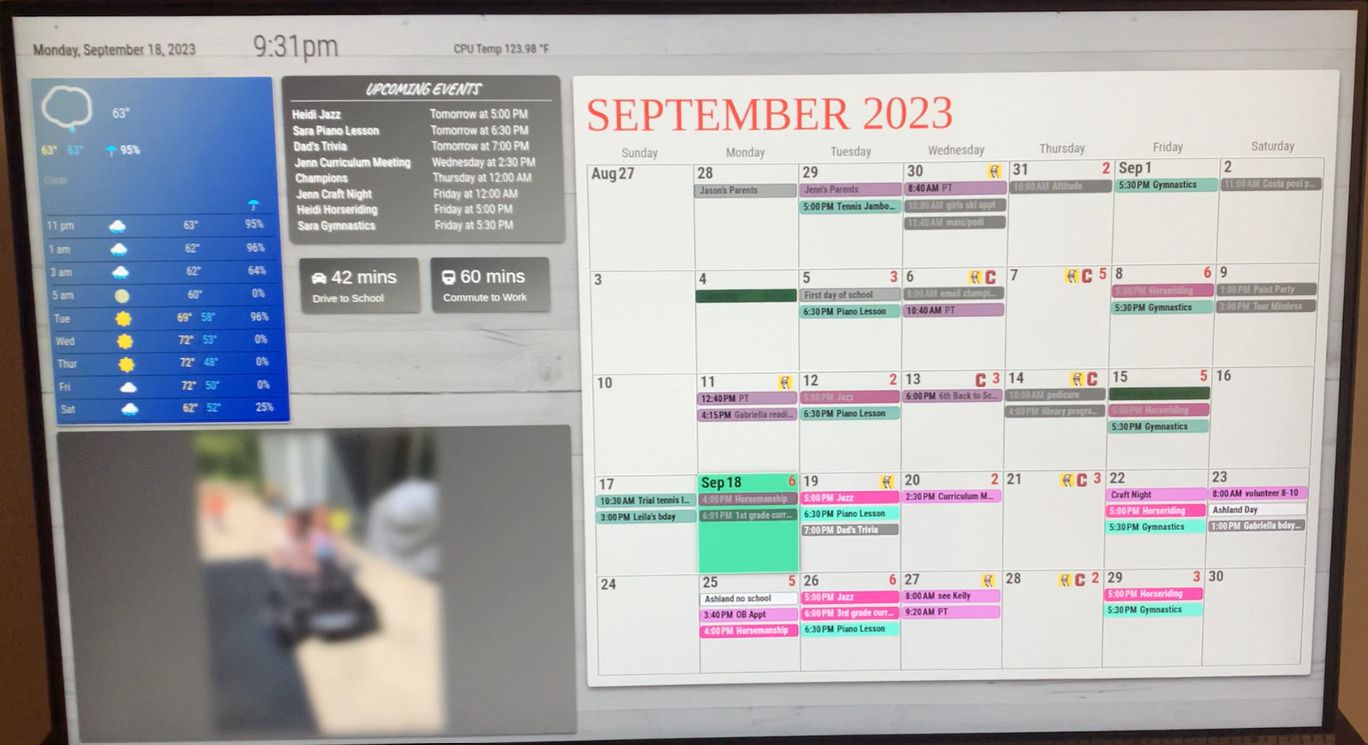

      I recently completed the software portion of my “Magic Mirror” that is really a touchscreen dashboard for the family to use, running on a Raspberry Pi4. I wanted to allow for family members to add/edit/delete events from the screen so we could replace our messy paper calendar. As shown, the dashboard also provides local weather, family photos, and commute times for both adults in the household. The next step is to build the physical housing around the screen, likely in the form of extending the bookcase it’s currently resting on. The finished product will be a built in.
      I’m not a programmer, but with the help of ChatGPT was able to develop a few custom modules to interact with others from the community. The most complex one I needed to develop was the integration with the Google Calendar API which was built entirely from scratch.
      Modules used:
      • MMM-DarkSkyForecast: Updated with PirateWeather
      • MMM-GoogleCalendar: Readonly Access to my Google Calendar via API
      • MMM-GooglePhotos
      • MMM-systemtemperature
      • MMM-Remote-Control
      • MMM-CalendarExt3: Heavy CSS adjustments along with a small update to add a transparent button in each date cell that brings open the add event dialog box.
      Custom Modules
      • MMM-Keypress: Simple swipe module allowing me to advance the calendar 1-10 months in either direction
      • MMM-TravelTimes: Pulls Google Traffic times for a drive to one location and a combination drive to train station/train ride to another
      • MMM-SimpleKeyboard: Integrates the public-use SimpleKeyboard into the MagicMirror
      • MMM-GoogleCalendarEventAdder: Provides Add/Edit/Delete functionality to our Google Calendar via API

          Realized as well that I forgot an actual screenshot in my OP.

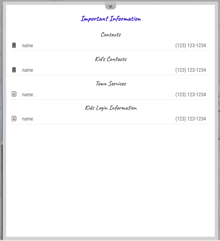

                    MMM-InfoPage: Loads as a collapsed module in the bottom left of the screen. The user then swipes up to expand and displays information my category. I’m using it to display phone numbers of key contacts, town services, and my kid’s login information for school apps. A few pictures below
