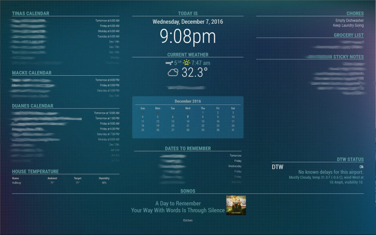

      Hello all,
      Thanks to Michael for his development of the Magic Mirror.
      I had grabbed a Pi to give it a go as a cheap media player. As I was impressed with this little wonder I started looking at what else was I might be able to do with it. Low and behold the magic mirror popped up. I wasn’t interested in a mirror but as a simple family info board it would work quite nicely.
      Needed a gift for the wife, and decided that would give me reason to purchase another PI. So I loaded up and started playing. Here is what I came up with (Thanks to many others on the forums as a gleaned info from so many places).
      Added Modules
      MMM-FAA-Delay
      MMM-Nest
      MMM-Wunderlist
      sonos
      calendar_monthly
      as well as a few tweaks to the Calendar module and a custom.css
      Thanks

      **Sorry all - with the Family Info Board working so well I haven’t visited the forums for quite a while and didn’t realize that my notifications were off. Here is the Background
      Here is the custom CSS

      Please keep in mind that this has not been updated from 2016, and may or may not have issue with the latest versions.
      Currently updating (Today) to the latest of everything and its time for a change in look…

        I like the styling, clean and sober! depending on screen size it can maybe be a bit cluttered?
        • W Offline
          Wedee
          Thanks, I was quite please with the feel.
          Yes I was concerned it was a bit cluttered but on a 29" monitor the sizing looks good, and the margins / padding seem pretty good. As its a Christmas gift for the wife and she has not seen it, I know that she will have input and want changes after Christmas. For now I have a functional board that does what I intended, and I am much better versed in making changes in css as well as installation and configuration of the modules. I imagine once she gets involved it will look very different the end of January.

            @Wedee wow this looks great! How did you add in the dates to remember as well as the chores, sticky notes, and grocery list?

              Dates to Remember is a shared google calendar. Running 4 shared calendars one each for wife, kid and me, and then the Dates to remember calendar.
              The sticky notes, chores, grocery list are shared Wunderlist lists.
              With the Wunderlist apps on our phones we can add or checkoff items. Kid wants more Ramen Noodles he can add to the grocery list Etc.

                @Wedee that’s awesome, I have to look into wunderlist. Is it possible to add the dates to remember calendar into the default us holidays calendar so that special dates show up in the same module?

                  Not sure if the generic US Holiday calendar can be added to, but you could create a new Dates to remember calendar and add the US holidays into it.
                  Wunderlist is pretty easy to use both the actual app, and adding in the module. Just be sure that you name your shared lists differently than the default ones… Grocery’s for example gets created on everybody’s account at setup… You need to add things to the shared list if you want it to show up.
