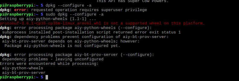

                    @sdetweil This leads to another problem…
                    I already have searched this issue in the past; I think something is wrong with Google itself possibly. This is the source: Setting up aiy-python-wheels: protobuf not supported on armv6.1 #526
