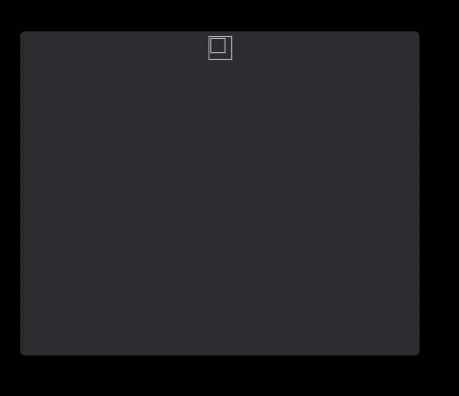

      Ok, this time no errors… Let me start MM:
      pi@raspberrypi:~/MagicMirror $ npm start run

      [16.01.2023 16:49.56.198] [LOG] MMM-SynologySurveillance: Received notification CONFIG
      [16.01.2023 16:49.56.200] [LOG] MMM-SynologySurveillance: Received notification INIT_DS
      [16.01.2023 16:49.56.202] [LOG] MMM-SynologySurveillance: Updating information of DS with idx: 0 and protocol https
      [50739:0116/164958.846579:ERROR:gl_surface_presentation_helper.cc(260)] GetVSyncParametersIfAvailable() failed for 1 times!
      [16.01.2023 16:49.59.003] [LOG] Create new calendarfetcher for url: https://calendar.google.com/calendar/ical/nl.dutch%23holiday%40group.v.calendar.google.com/public/basic.ics - Interval: 300000
      [16.01.2023 16:49.59.045] [LOG] Create new calendarfetcher for url: http://p103-caldav.icloud.com/published/2/Njc3ODUzOTEzNjc3ODUzOQyRiARRL2CkxgtBVQDZXfBmcEh4jRSjf1NpTv-kmUkeab9A4t6LtTrrc3BUTsPoy9oS4yCg4f5Rnt5FlMRu6Oo - Interval: 300000
      [16.01.2023 16:49.59.056] [LOG] Create new calendarfetcher for url: http://p62-caldav.icloud.com/published/2/MzE2ODIwNDE4MzE2ODIwNJD9RGBryCg63_2az9y7tWOTHmUDf_W0Y3YkBa1tdgnP7AW7ihN1TLzhWzBnHSok2S9kxwdK6IkOT1I55L8cvuE - Interval: 300000
      [16.01.2023 16:49.59.065] [LOG] Create new calendarfetcher for url: http://racingnews365.nl/ics/download/calendar-formula-2022.ics?all - Interval: 300000
      [16.01.2023 16:49.59.070] [LOG] Create new calendarfetcher for url: https://wasteapi.ximmio.com/api/CallIcal?cn=Gemeente Almere&x=53d8db94-7945-42fd-9742-9bbc71dbe4c1&ty=null&ua=65222&sd=2021-12-21&ed=2025-01-09&path=https://wasteapi.ximmio.com&ln=nl&nt=1130 - Interval: 300000
      [16.01.2023 16:49.59.285] [LOG] Create new newsfetcher for url: http://feeds.nos.nl/nosnieuws - Interval: 300000
      [16.01.2023 16:49.59.291] [LOG] Create new newsfetcher for url: https://nl.motorsport.com/rss/f1/news/ - Interval: 300000
      [16.01.2023 16:49.59.294] [LOG] MMM-Formula1 received a notification: CONFIG
      [16.01.2023 16:49.59.315] [LOG] MMM-Formula1 is fetching the race schedule for the current season
      [16.01.2023 16:49.59.342] [LOG] MMM-Formula1 is fetching DRIVER standings for the current season
      [16.01.2023 16:49.59.347] [INFO] Checking git for module: MMM-connection-status
      [16.01.2023 16:49.59.390] [INFO] Checking git for module: MMM-SynologySurveillance
      [16.01.2023 16:49.59.467] [INFO] Checking git for module: MMM-Formula1
      [16.01.2023 16:49.59.554] [INFO] Checking git for module: MMM-Buienradar
      [16.01.2023 16:49.59.594] [INFO] Newsfeed-Fetcher: reloadInterval set to ttl=6000000 for url https://nl.motorsport.com/rss/f1/news/
      [16.01.2023 16:49.59.698] [LOG] MMM-Formula1 is returning DRIVER standings for the current season
      [16.01.2023 16:49.59.704] [INFO] Checking git for module: MMM-SolarEdgeLite
      [16.01.2023 16:49.59.781] [INFO] Checking git for module: MMM-SystemStats
      [16.01.2023 16:49.59.923] [INFO] Checking git for module: default
      [16.01.2023 16:49.59.982] [INFO] Newsfeed-Fetcher: Broadcasting 50 items.
      [16.01.2023 16:50.00.666] [INFO] Calendar-Fetcher: Broadcasting 0 events.
      [16.01.2023 16:50.00.713] [LOG] MMM-SynologySurveillance: Found cam Generic_ONVIF-001
      [16.01.2023 16:50.01.085] [INFO] Calendar-Fetcher: Broadcasting 26 events.
      [16.01.2023 16:50.01.252] [INFO] Calendar-Fetcher: Broadcasting 31 events.
      [16.01.2023 16:50.01.389] [INFO] Newsfeed-Fetcher: Broadcasting 20 items.
      [16.01.2023 16:50.01.750] [INFO] Calendar-Fetcher: Broadcasting 18 events.
      [16.01.2023 16:50.02.554] [ERROR] Moment Timezone has no data for GMT+0200. See http://momentjs.com/timezone/docs/#/data-loading/.
      [16.01.2023 16:50.02.555] [ERROR] Moment Timezone has no data for GMT+0200. See http://momentjs.com/timezone/docs/#/data-loading/.
      [16.01.2023 16:50.02.556] [ERROR] Moment Timezone has no data for GMT+0200. See http://momentjs.com/timezone/docs/#/data-loading/.
      [16.01.2023 16:50.02.569] [INFO] Calendar-Fetcher: Broadcasting 10 events.
      [16.01.2023 16:50.02.884] [LOG] MMM-SynologySurveillance: {
      “dsIdx”: 0,
      “camStreams”: {
      “Generic_ONVIF-001”: “https://datanas//192.168.2.26:5000/webapi/entry.cgi?api=SYNO.SurveillanceStation.Stream.VideoStreaming&version=1&method=Stream&format=mjpeg&cameraId=2&StmKey=“c0a94e2b77e2887405161edf7a32964b””
      [50702:0116/165002.966141:ERROR:cert_verify_proc_builtin.cc(670)] CertVerifyProcBuiltin for datanas failed:
      ----- Certificate i=0 (CN=synology,O=Synology Inc.,L=Taipel,C=TW) -----
      ERROR: No matching issuer found
      [50739:0116/165036.029773:ERROR:gl_surface_presentation_helper.cc(260)] GetVSyncParametersIfAvailable() failed for 2 times!
      And this is what the MM is showing:
      Before I got the little cam showing, now it is this square. Any thoughts?
      • D Offline
        digied @wishmaster270
        @wishmaster270 btw, the cam itself is found:
        [16.01.2023 16:55.55.543] [LOG] MMM-SynologySurveillance: Received notification REFRESH_URLS
        [16.01.2023 16:55.55.544] [LOG] MMM-SynologySurveillance: Refreshing the urls!
        [16.01.2023 16:55.55.545] [LOG] MMM-SynologySurveillance: Updating information of DS with idx: 0 and protocol https
        [16.01.2023 16:55.57.908] [LOG] MMM-SynologySurveillance: Found cam Generic_ONVIF-001
        [16.01.2023 16:55.58.816] [LOG] MMM-SynologySurveillance: {
        “dsIdx”: 0,
        “camStreams”: {
        wishmaster270W 1 Reply Last reply Reply Quote 0
        • wishmaster270W Offline
          wishmaster270 Module Developer @digied
          @digied That log looks totally different than the other one. What did you change?
          D 2 Replies Last reply Reply Quote 0
                  @digied Hi,
                  it’s nearly perfect. Now the needed library and the access to the NAS works.
                  The output of your log shows that the fetched URL contains the hostname of your NAS AND the IP.
                  Maybe there is a bug in my replaceHostname function.
                  Your config contains a replaceHostPart set to true.
                  Can you set it to false please.
                  Edit: Now that I see all your posts things are clearer ;-)

                    • D Offline
                      @wishmaster270 Great! I did see the certificate error so I changed the https/5001 into http/5000 in the config and now the log shows this:
                      [16.01.2023 20:49.14.962] [LOG] MMM-SynologySurveillance: {
                      “dsIdx”: 0,
                      “camStreams”: {
                      “Generic_ONVIF-001”: “http://datanas//192.168.2.26:5000/webapi/entry.cgi?api=SYNO.SurveillanceStation.Stream.VideoStreaming&version=1&method=Stream&format=mjpeg&cameraId=2&StmKey="6058a182182e0c518d126bbf69e2e350"”
                      [73749:0116/204923.065357:ERROR:gl_surface_presentation_helper.cc(260)] GetVSyncParametersIfAvailable() failed for 1 times!
                      [73749:0116/204930.176714:ERROR:gl_surface_presentation_helper.cc(260)] GetVSyncParametersIfAvailable() failed for 2 times!
                      [73749:0116/204930.183104:ERROR:gl_surface_presentation_helper.cc(260)] GetVSyncParametersIfAvailable() failed for 3 times!
                      [16.01.2023 20:50.05.716] [LOG] MMM-SynologySurveillance: Received notification REFRESH_URLS
                      [16.01.2023 20:50.05.718] [LOG] MMM-SynologySurveillance: Refreshing the urls!
                      [16.01.2023 20:50.05.719] [LOG] MMM-SynologySurveillance: Updating information of DS with idx: 0 and protocol http
                      [16.01.2023 20:50.08.721] [LOG] MMM-SynologySurveillance: Found cam Generic_ONVIF-001
                      [16.01.2023 20:50.09.721] [LOG] MMM-SynologySurveillance: {
                      “dsIdx”: 0,
                      “camStreams”: {
                      Now the certificate error is gone, but still no image from the cam.
