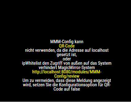

                    ok, i’v tested your fix. at the moment your module do not work for. in mm says i use localhost, but in my config i have addressed at 0.0.0.0 and ipWhitelist: []
                    i send you the result of pm2 logs --lines=100. one for test without MMM-Volume and one with.
                    i hope it’s help you.

                        sdetweil @stoffel
                        @stoffel ok, fixes… in branch newform…
                        on the QR code messages I was changing address AND ipWhitelist EMPTY…
                        i only check address now, and assume you know what you are doing on whitelist
