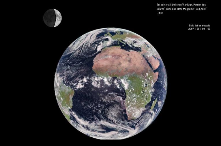

                  • R Offline
                    rkorell @cricket
                    @cricket said in MMM-Moon module - how to resize?:
                    It appears there is no size option in the module itself. I
                    I’ve had the same issue not with size but with alignment and had resolved this within the middle-center region and have used:
                    .region.middle.center {
                      width: 45%;
                    in custom.css.
                    This works for me to position the moon nicely above earth in my implementation.
                    Regards,
