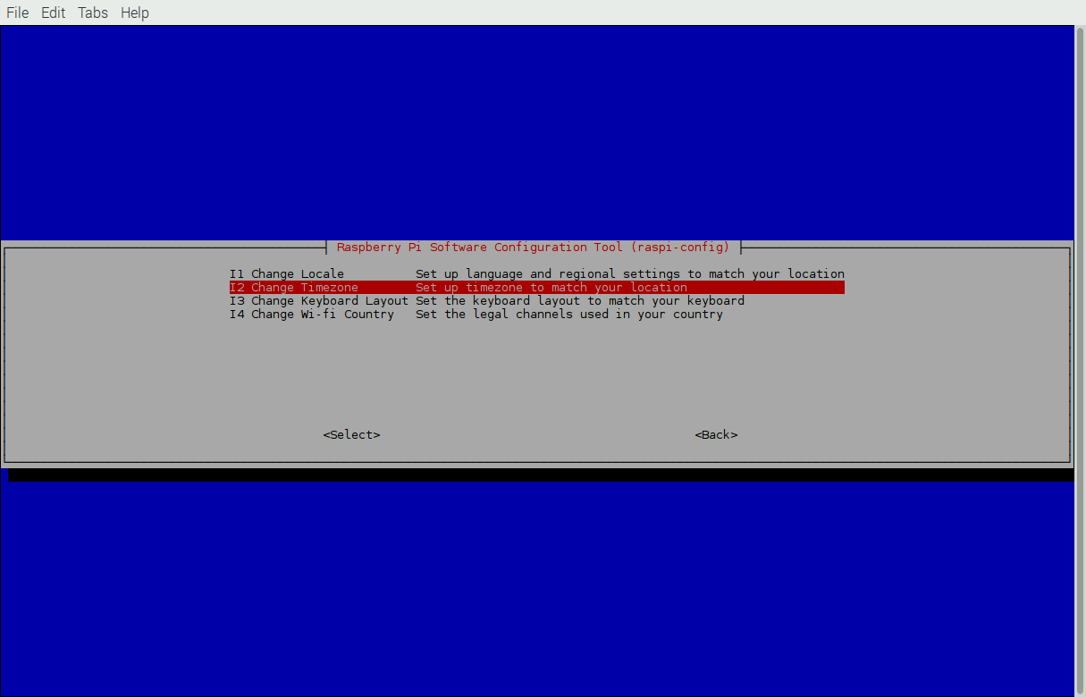

          Now we’re going to configure the Internationalisation Options. This will configure your rpi to use the correct language, timezone, and others. Select that option (5) and hit enter/return.

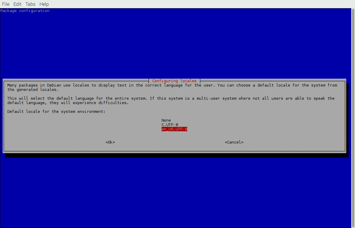

          Select the first option, Change Locale (I1)
          Now scroll to your preferred language using the up/down arrow keys. In my case, I’ll be using US English as opposed to the default GB English. Press your space bar to select your preferred language, and don’t forget to un-select the default. one. And I specifically picked the UTF version because it supports any Unicode character. ISO-8859-1 only supports the first 256 characters.
          Once you complete that step, you’re back at the main menu. Select the Internationalisation Options again, and go to the second option, Change Timezone (I2)
          Start by picking your region, then the respective timezone that you’re in. In my case, I’m in the US, living in the Mountain timezone
          Once again, when you finish that, it takes you back to the main menu. Get back to the Internationalisation Options and pick the third option, Change Keyboard Layout (I3). The default is a standard UK, full size keyboard. If that’s what you’re using, then you don’t need to do this. However, it’s still worth looking at in case you do happen to have a different keyboard. I wanted to change mine to a US keyboard instead.
          By default the Generic 105-key (Intl) PC version is selected. For most cases, that’s fine, just hit enter/return on that and it will take you to the layout option. Note the default UK settings:
          Since I wanted a US layout, I selected Other.
          On the next screens, I picked the English (US) for the country, again English (US) for the layout,The default for the keyboard layout, and No compose key
          At the end of this, it will ask you what you want the CTRL-ALT-Backspace combination to do. Normally it does nothing, but it can be configured so that if you hit that combination, it instantly kills the X-Server (and depending on the OS setup, will restart it fresh.) This was a more applicable when X11 was still in its infancy and things crashed a lot. Over the years, things became more stable, threads started getting removed from the main process, so applications could be killed and restarted without needing to completely kill the X-Server itself. However, it’s still around today. I have yet to have the X-Server on my rpi crash on me, ever. And if things really get completely bogged down, I just restart it remotely. Specially since this isn’t going to have a keyboard on it, there’s no sense in configuring this option, so I left it as No.
          Ok, one more time, go back into Internationalisation Options and pick the last item, Change Wi-fi Country (I4). This will set the correct channel frequencies available. In the US, channels 1 through 11 are common. Channels 12 and 13 are allowed, but for low power only, and channel 14 is forbidden. For the rest of the world, channels 12-13 are not restricted. And for those in Japan, well aren’t you guys special … you get to use channel 14 as well (only specific protocols.)

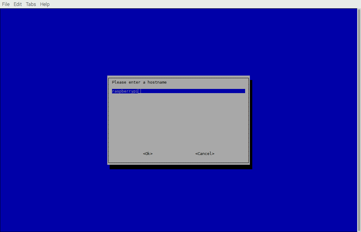

          Scroll down to Advanced Options and select it. Pick the second option, Hostname (A2). Here you will give your rpi a name. By default it’s raspberrypi but why be like the rest of the world? You can change that.
          Make sure you read the warning that pops up, then set the name to whatever you want. For example, I changed mine to magicpi … after all, it will be running MagicMiror! (the screen shot shows the default setting)
          Once back at the main screen, pick Advanced options again and scroll down to SSH (A4). I like having the SSH server running because it allows me to connect to the rpi from anywhere on my network using a terminal program. So I don’t need to have a keyboard and mouse connected to the rpi itself, I can log into it using a different machine. But if you don’t need/want this, you can turn off/on the SSH server. In this case, I wanted mine turned on
