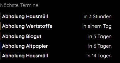

                Hi all,
                I’m not quite sure how to achive that relative time format is displayed correctly. Please notice the given picture
                Where it says “in 3 Stunden” (german for in 3 hours) it should say tomorrow and where it says “in einem Tag” (german for tommorow) it should be the day after tommorrow as the event starts tomororw plus a few hours.
                Any suggestion how to achive that ?
                M 1 Reply Last reply Reply Quote 0

                      MMRIZE @gekberlin
                      @gekberlin
                      RelativeTime would be auto-scaled by remain period to target time from now on. So “tomorrow” is displayed as “in X hours” because after X hours the tomorrow will begin. “In 10 days” means exactly “in 10days and a few hours”
                      So it is not so desirable to display exact time, especially fullday events.
                      Use dateFormat or dateTimeFormat. See the localization part also.
                      RelativeTime itself is more useful when you use it to display near events in 24 hours.
