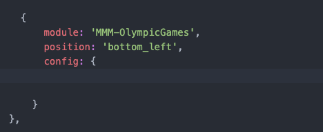

First I cloned the MMM-OlympicGames to my modules folder
then added to my config file (see below)
module: 'MMM-OlympicGames',
position: 'bottom_left',
then I ran npm install --production in ~/MagicMirror/modules/MMM-OlympicGames directory.
added Locale to the default settings
locale: "en-US",
then I restarted the MM and it still says loading…
