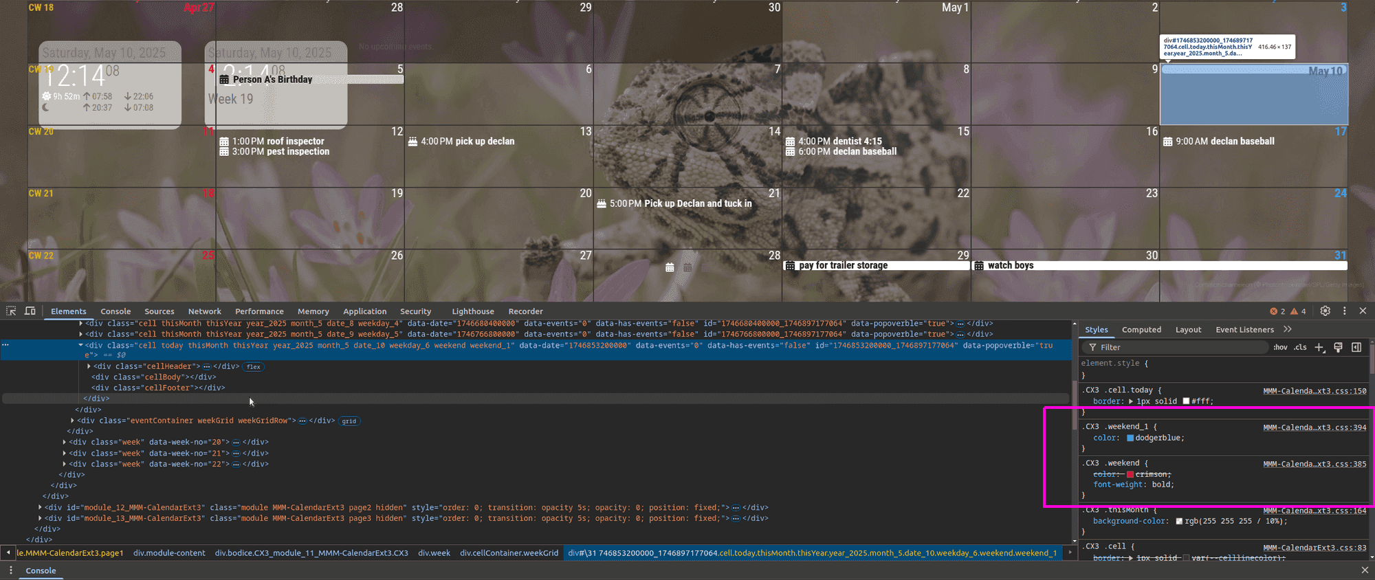

            Thanks. I was able to figure out the element and change the background color. I a first time user of the developer tool and so a little confused.
            The background color was not declared in custom.css, is that why they are crossed out in the web developed element? See the image at the end.
            Also is there a default setting in web developer which I can resort to, after I have changed things around and clicked on several things not knowing what I am doing!!?? Thanks.

              @sankum strikethru means that style is overridden by some other declaration and typically that is shown higher up (closer to the top) in the right hand column
              css has the concept of specificity
              a more specific style will override a more general one
              so if you had a text color on a dic and a text color on a span inside the div, the text color of the span would be chosen as its more specific
              sometimes you have to force it by adding !important after the style
              the condition needing this would be a lower style overriding an upper one
              if a style is unchecked, then it is not applied at all. like commented out

                  @sankum just for discussion on a couple points from your image above
                  in the css stack pane on the right, you see
                  .CX3 .weekend
                  has a couple styles, specified in MMM-CalendarExt3.css, line 385
                  and one of those styles has a strikethru, color
                  an item higher up in the stack list, also shows a DIFFERENT class
                  .CX3 .weekend_1
                  that ALSO specifies the same style, from the same file but line 394 (further down is processed later, so it overrides stuff set ABOVE this line…(cascading)
                  so you can see the style(and where its set) , see it is overridden(and from where)
                  and the element selected (left side of element view) shows BOTH classes applied
                  NOW , this second style setting/weekend_1 demonstrates a problem, as you MODIFIED the module shipped file of css settings… and next time the module wants to update, it will FAIL as you changed one of ITS files…
                  MM is designed to avoid this problem, you place ALL ‘custom’ (local to you) css in the file
                  MagicMirror/css/custom.css
                  we load this file LAST, so it overrides ANYTHING set before it was loaded…
                  base, module, or anything higher in custom.css too…
