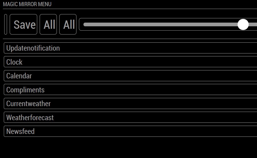

          i all i’m new to this world so bear with me plz,
          I have built en set-up my daughters SM ( she’s 7 so made her a Disney “mirror, Mirror on the Wall” kinda thing.
          I have set up most of the basic stuff, work in progress is;
          motion sensor
          voicecontole
          and the darn MMM remote control
          the last one gives me heaps of trouble, i’ve managed to fix a lot problems by trial and error, using this forum as a guideline.
          There is one thing, picto’s and “sliders” to turn on off stuff on my phone, i havent been able to fix.
          I’ve read and applied all the suggested fixes on the forum.
          everything works but i’m unable to see if a module is on or off on my phone.
          can anyone point me in the right direction, i’m lost atm… not native english (correct my grammer i dont mind, infact it helps)
          thanks in advance
          p.s. new to programming so be gentlealt text
          StoffbeuteluweS 1 Reply Last reply Reply Quote 0
          • StoffbeuteluweS Offline
            Stoffbeuteluwe Project Sponsor @apster
            @apster - the font awesome package was updated in v2.7 so the direct reference to FA in remote.html will need to be updated.
            It looks like this line
            link rel=“stylesheet” type=“text/css” href=“vendor/node_modules/font-awesome/css/font-awesome.min.css”
            Should be changed to
            link rel=“stylesheet” type=“text/css” href=“vendor/css/font-awesome.css”
