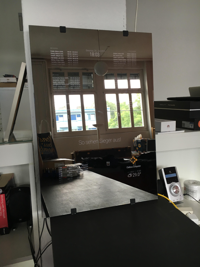

I would like to present you my MagicMirror2
Here is my frameless mirror project. I like this style a lot.

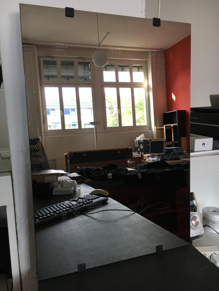

Here you can see the difference between the 12 % and 20 % mirror.
The room has big windows.
12%:
20%
frame:
