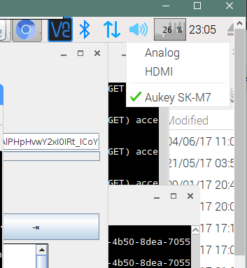

@Mykle1 If you’re on jessie (with pixel), keep reading this post. I think you mentioned you have blueman installed. You don’t need blueman anymore. I would recommend getting rid of it. Pixel comes with pi-bluetooth which is supposed to make things easier for audio. Notice how you have 2 bluetooth icons in your taskbar? They could be conflicting.
Please also see this link https://www.raspberrypi.org/blog/another-update-raspbian/ for how to connect the speaker. It should work.
Of course do back up your card in case something goes wrong.
Raspbian Stretch also changed some stuff about bluetooth, maybe take a look at that if you have a spare sd card lying around. I personally haven’t tried it yet.
https://www.raspberrypi.org/blog/raspbian-stretch/
This is how mine looks
