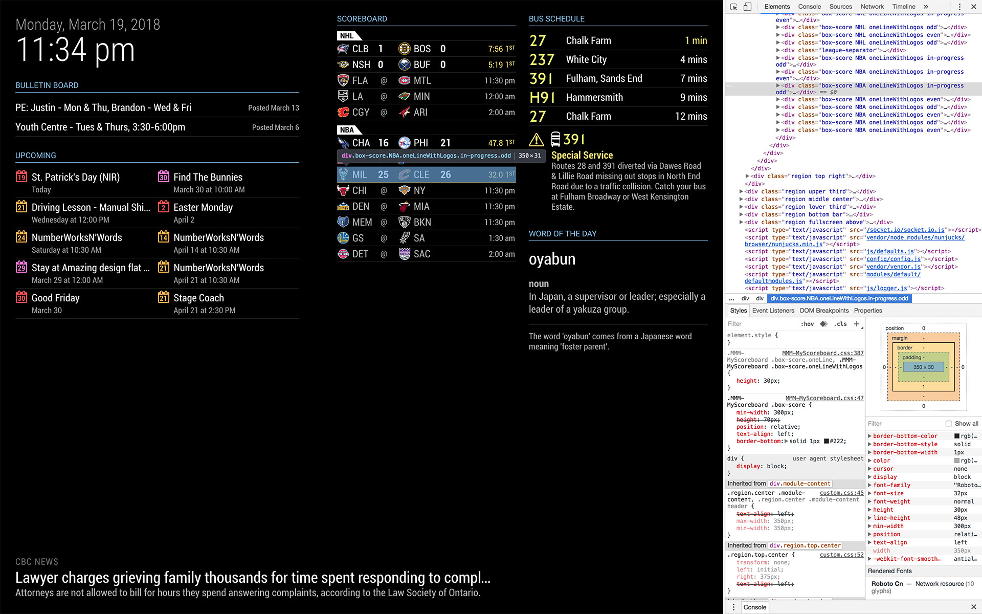

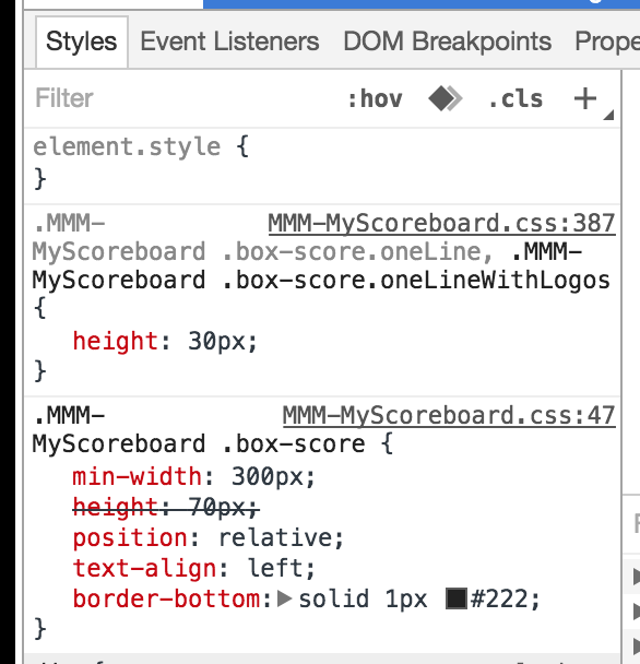

- How to use MagicMirror in Dev mode to inspect an element to see the CSS rules applied to a given element
