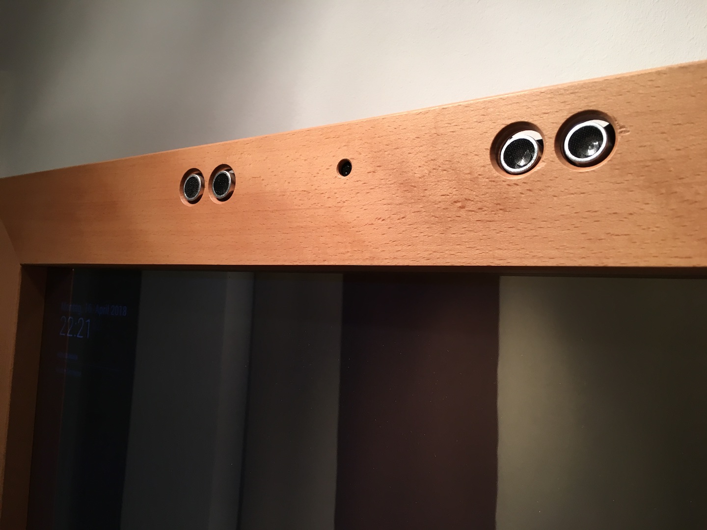

Hi @nawak86, after setting up the two HC-SR04 sensors, I am not very happy with its performance. It basically works, also with the Pages module.
It sounds like @thobach is pretty happy with his gestures module (even you need an Arduino besides the Pi, right?).
Here is a picture of how I integrated the sensors into my mirror, I could maybe upload a video in the next days.
For connecting everything you need the two sensors, jumper wires, 2 times a 1k Ohm resistance, a breadboard.
